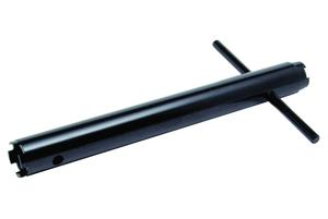

Not sure we are talking of the same operation : my concern is just to reach the spring, to replace it.
I got some answers from SBKen and other on a french forum, that make me think that this 4 holes cap can be unscrewed with a tool who would look like this :
