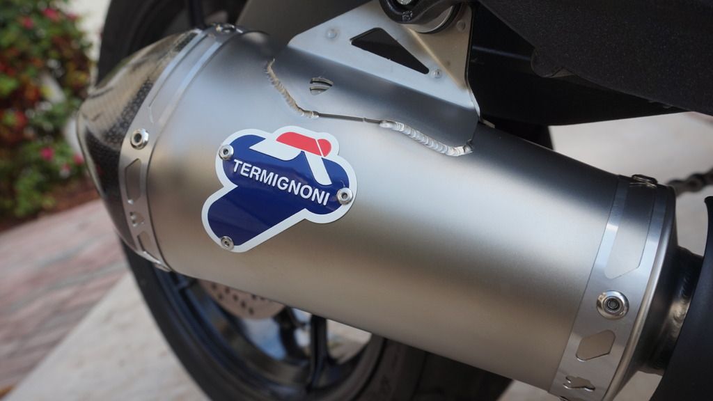

On a side note, while the bike was there I had them fit the Termignoni Race Pipe. Holy S***! What a different bike! All throttle jitter is gone, and it sounds fantastic! Absolutely awesome.
