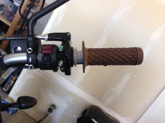

I know a fair number of people here have fitted the Biltwell Thruster Grips so I am curious how you have resolved the issue of the grip being much shorter than the standard one as shown below? Did you change out the throttle tube? The grip is about half an inch too short and suspect the stock Ducati grip is longer than an industry standard.

You are right and I must have taken stupid pills this morning. Rest assured I did take the bar ends off. I simply wasn't aggressive enough in getting the new grip on but I still came across something I'll add in my next post.

Okay the image is displaying properly in Photoshop so I am not going to worry about it here.
But here is the one change I made. If you look at my original photo, you can see the white throttle tube has a lip on it that the Biltwell grip can't cover up. The stock Ducati grip fits over this and you'll see what I mean if you ever pull the grips off and compare them side by side. But since I don't want the tube getting debris inside it, I cut that portion off and slid it onto the tube here as seen below. I should probably seal the two in some way but at least this is better than the bare plastic.
In addition, the Biltwell grips, when fitted properly, interfered with the operation of the throttle. As you know the stock grips have the ends removed so the bar plugs will fit. So one needs to either move the throttle tube in further or cut the ends of the grip out and utilize the same bar ends to prevent the Biltwells from catching on the throttle tube. I chose the latter.
