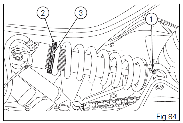

Thank you all. How do I wind back the preload? which direction do I turn? anti-clockwise or clockwise?
It's regular threaded. Unscrew the locknut 2 first, next you need to unscrew the preload collar 3. In my experience this goes best if you spray some WD-40 on the threads of the shock first, and then grab the spring itself and twist it in the right direction.
Once done tighten the locknut 2 back against the collar.
(this is in your manual btw)
I'll add that a little bit goes a long ways. A 1/4 of a turn can be felt.
And you don't need to tighten the jamb nut very hard.
Your arse is better than mine when it comes to preload changes, but yes, it doesn't require much.
Clockcwise the springs gets shorter, more preload.
Anti-clockwise, longer, less preload.

Thank you, Pmedina. I read the manual and the pics helped. Winding clockwise is making it more tight so it gets shorter. going anticlockwise it expands...I will check the test ride bike rear preload and I will set it accordingly. I guess the special tool that is used to set it must be underneath the seat in the small tool bag.
I never used it tbh. Always afraid it will slip off cutting up your knuckels.
Instead, I unlock the locknut with a few gentle taps on a big screwdriver, and rotate the complete spring to change the preload.
