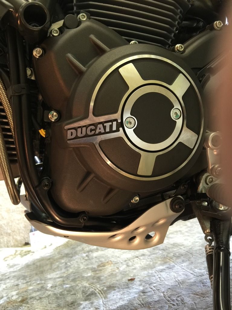

I was pleasantly surprised how robust this item is, :)
Note ! Don't try to fit this yourself if you're not mechanically minded :rolleyes:
There are about 20 bits and pieces to figure out, and you don't get any instructions either, But all the items are well made and powder coated, the pan is anodised ,
Once its all fitted it's an easy job to remove just the pan, 3 bolts , then you can change the oil filter,
I'll post more pics if anyone needs them :rolleyes:

There a 4 stand off bolts, to replace engine bolts,
3 brackets, 2 on the left side of the bike and 1 on the right side,
On the first pic you can just see the two brkts on the left , the half moon one at the front and one just in front of the prop stand,
I'll take some better pictures for you of the brackets later this week,
ps, On the left side I removed the cable camp as it's not needed when the belly pan is in place
