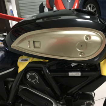

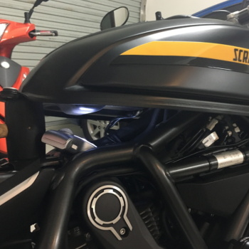

Let's change the fuel tank! This action a lot of people are asking, maybe I have another note.
Even the pump are removed and replaced on the new tank.
You can change from the old tank to the new tank,
Looks like a picture underneath.
PS: Before filling the tank, add some gas, test whether it will leak
Then wash dirty hands ... Put on a nice sticker
