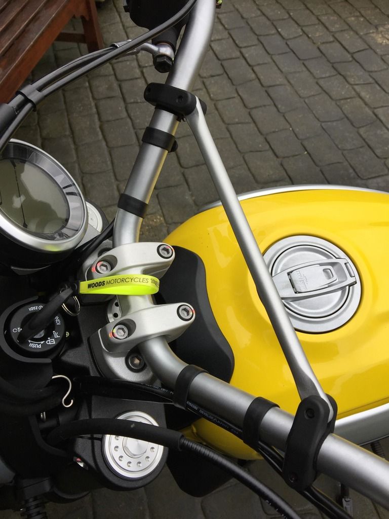

Just a little tip really !
I bought the brace the other day, and started to assemble it, Well it wouldn't assemble because the counter bored holes had created a massive burr on the 6.5 mm drilled hole, the only way was to re drill the holes with a 6.5 drill, It's so easy to scratch the handlebars too, so I ran two lengths of masking tape either side of the bars, fit and adjust without scratching ,peel off the tape after assy, And don't forget to cover the tank just in case you drop something on it,

Nice, I have one on order and I thought it might have rubber strips to place between the bracket and handlebar but seems not. Might be an idea I ask dealer to not attach it so I can take care putting it on. Thanks for the heads up as would not be too happy with marks on the bars. I wonder if those getting Urban Enduro models will have said marks.

Sorry Elvis I did not mean to hijack your post... Thanks for the pic as looks great. I think I will wrap newspaper round the bars and use a bit of tape at the top so then it all slides off easily :)

Have my brace now and all fits together well so no need for me to drill anything Elvisto. Looks like it will work well with the Ducati handlebar bag and just need the bike now to be sure...
