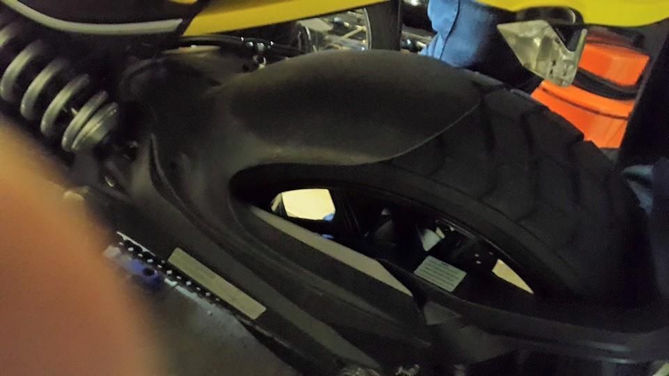

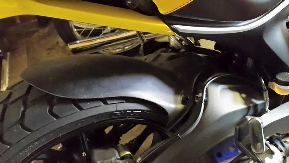

So I saw a comment months ago whilst we were drooling, contemplating how it would be etc ( and yes some still are
but it was questioned whether one could put one on it.
Well as you do have a couple of Monster ones laying around in your garage loft that no-one will give you a fiver for I kept them for when someone is desperate. My old s4 one and a 696 one my mate gave me as he emigrated to Australia and didn't want to take all the OEM stuff.
So tonight I tried the 696 1st as its shorter and thinner ( lighter) and more minimalist. This is what it looks like just layed on and one of the holes lines up with the brake pipe cable mount. The other side would need drilling and tapping on the arm but plenty of room to do so. The front should be the same too. Now the only thing different is the chain guard cover goes at a steeper angle up but I would cut that off and blend it if I tried.
So please voice your opinion and just letting you know it could be an option you would like to try as plenty of 696 huggers on ebay and carbon fibre if you desire too.
