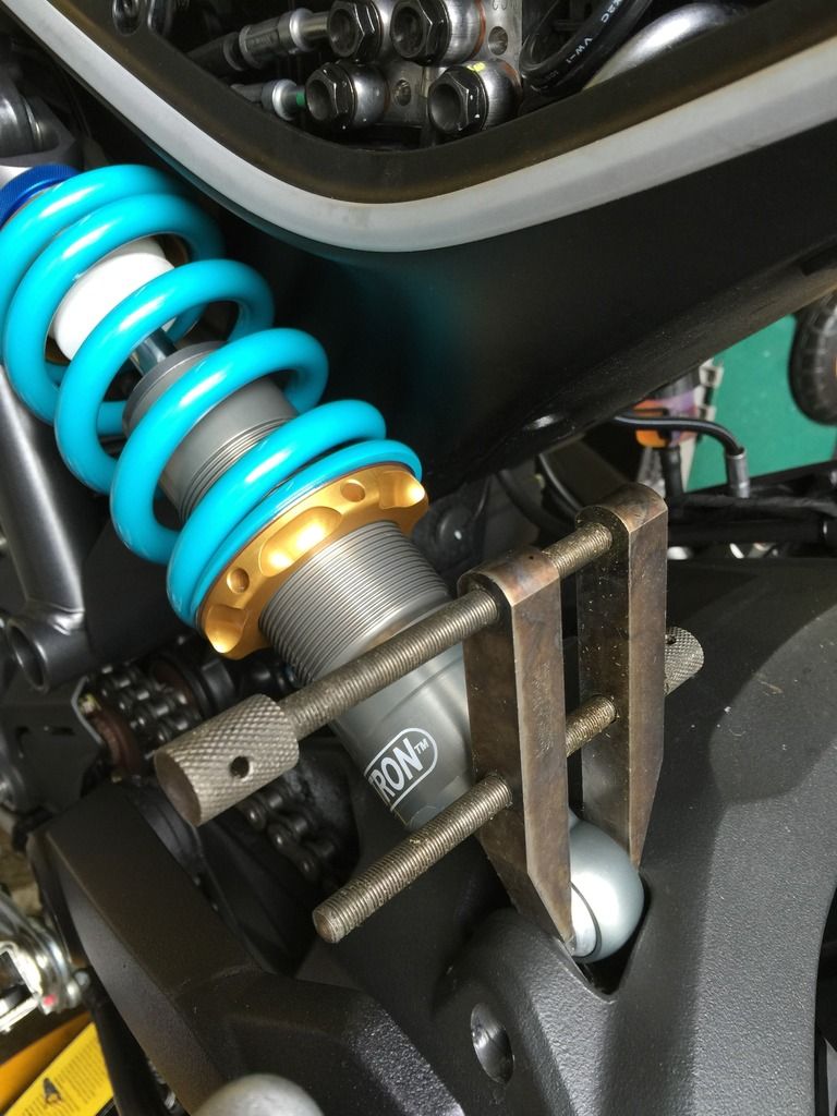

I used a paddock stand and a trolly jack to support the bike while removing and refitting , You need to be able to jack the bike under the rear part of the engine to remove it,
The bottom bolt can be a little difficult to get back in ,you just have to jack it up more to give some room,
I put the bottom eye in first, Its a bearing with side plates and "O" rings it needed to be compressed a little so I used a toolmakers clamp and it then slid in just fine,

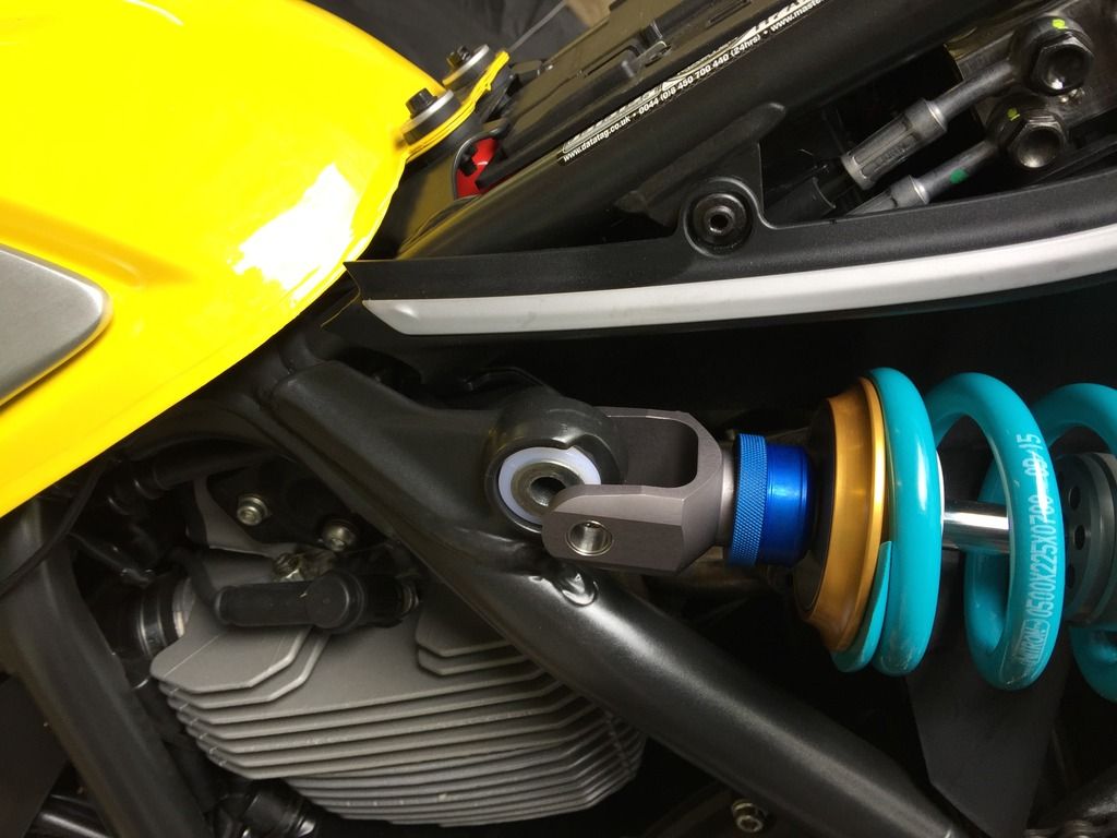

The top fixing is a proper machined "U" bracket, with an alloy spacer that just slid into place, everything lined up perfectly, as it should, ;)
There are stainless steel inserts for the bolt to tighten up on,and a high tensile bolt supplied with the kit
